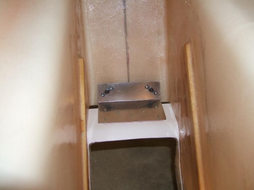

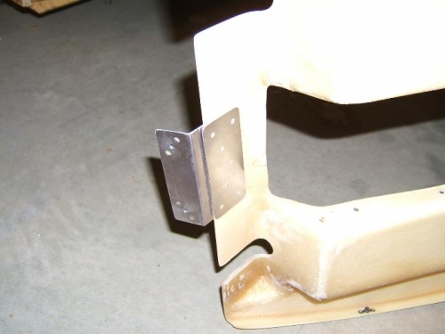

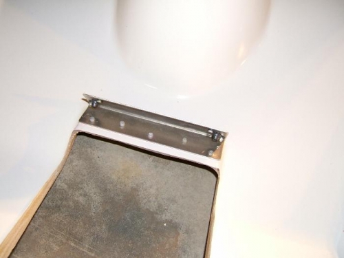

Located and drilled front pod to seatpan bracket, installed nut plates, drilled and counter sunk backing plate.
Removed instrument pod.
Drilled rear pod to seatpan bracket for five 1/8" rivets.
Adjusted two frame tabs under right side of seatpan so they sit against the fiberglass without pulling when the bolts are tightened.
Removed seatpan from frame.
