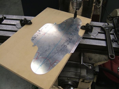

More locating of instruments, resized and cut out pictures of instruments to determine clearences.
Screwed panel down to a piece of trupan and clamped it on the mill bed. Cut four 2.04" holes for engine instruments. Cut 2.875" hole for rotor tach.
Cutting the first hole
Printed templates help with tight tolerances
More hole cutting
