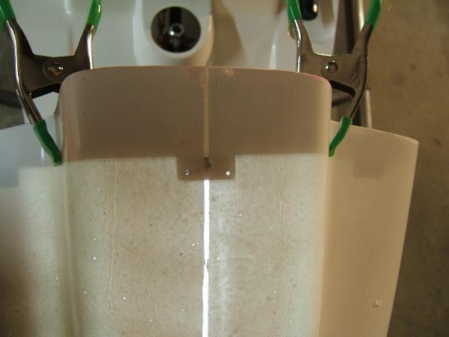

Brief Description:  Instrument panel mounting
Located and drilled 5 mounting holes in upper inst. panel. Installed nut plates to 5 angle mounts, attached them to the panel and located it in the pod. Used a light inside the pod to shadow the angle mounts and drilled rivet holes through them from the outside.
Marking mount locations
Panel mount nut plates installed
Back lighting beats measuring.
