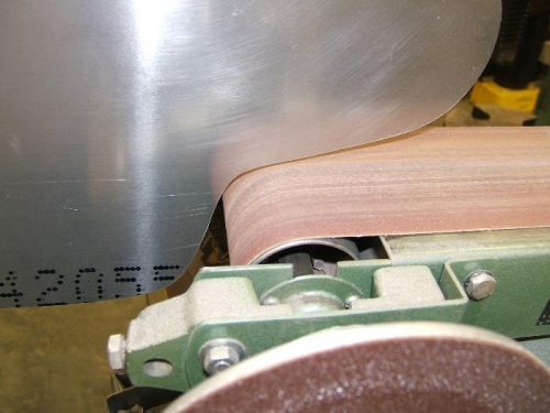

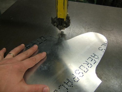

Brief Description:  Panel, inst. pod
Cut instrument panel from .050 aluminum, fitted along with lower panel. Cut panel mounting angles, fabricated front pod to seatpan attachment from .050 aluminum. Bent angles on bottom of main panel to match lower panel.
Ready to rivet panel mounting plates/angle in pod and drill and install nut plates.
Cutting out the inst. panel
