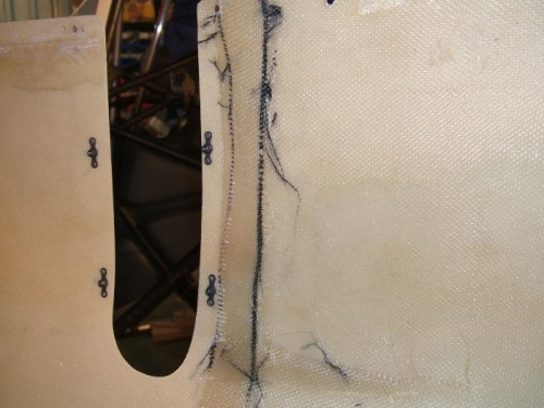

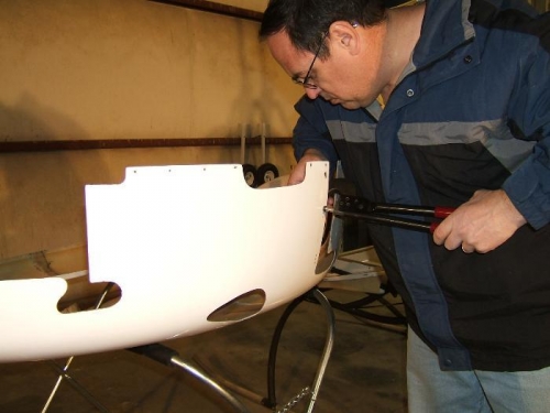

Cabin nut plates
Marked drilled and installed nut plates for lower cabin cover plates and inaccessable windshield nuts (#6 floating nut plates).
Used 3/32" counter sunk aluminum rivets installed with rivet squeezer.
Floating nut plate
