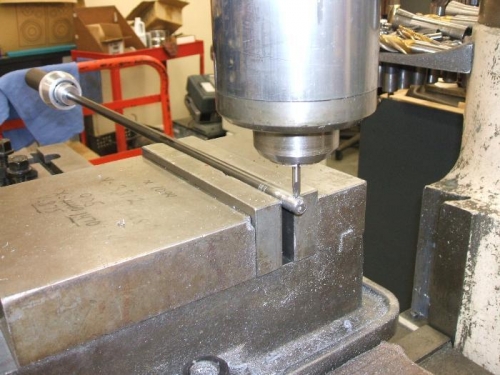

Throttle friction, potentiometer adapter

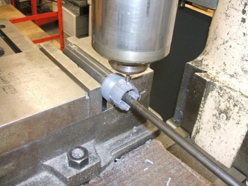

Cut four grooves in throttle friction inner collar so it can be sqeezed down on the collective tube by the friction outter collar.
Drilled hole in the end of the throttle tube for the potentiometer adapter bolt to key into.
Slotting throttle friction collar
4 slots so collar can squeeze tube
Hole for travel limit bolt
