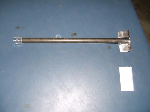

Lift Strut

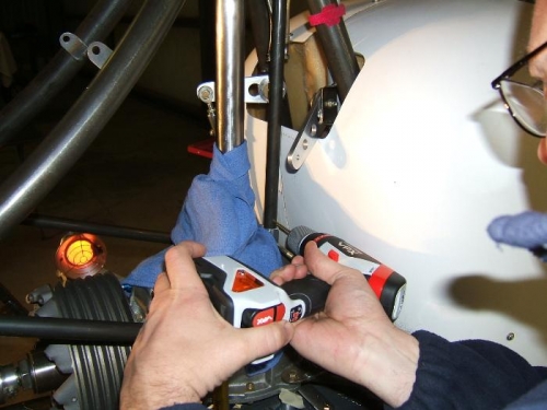

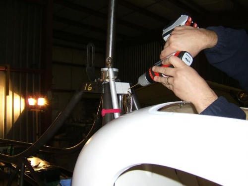

Finished fabrication of lift strut, had top plate welded to tube, fit and clamped, drilled top holes and cross bolt for lower clevis
