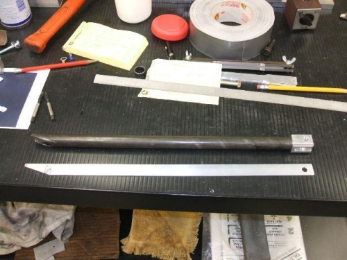

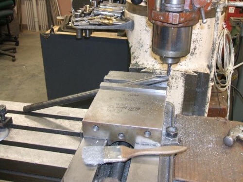

Lift strut
Fabrication of lift strut, machined aluminum clevis for lower end and cut upper end of tube to 19 degree angle to match hood bracket. Still need to weld plate to upper end then install and match drill upper plate with hood bracket.
Milling angle on top end of strut
Clevis finished
Testing top angle
