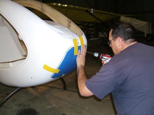

Bottom gear covers, cabin trimming, Chin window

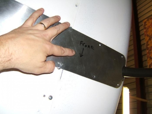

Final fit front gear cover and drilled mounting holes. Will install nut plates when cabin is removed. Marked rear gear cover for trimming to width,

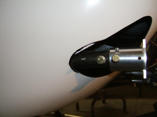

Marked cabin for additional trimming around fron gear tubes, rear collective/throttle opening, left rear frrame opening, and top left frame opening.
Final fit chin window and drilled 11 mounting holes, reamed and chamfered.
