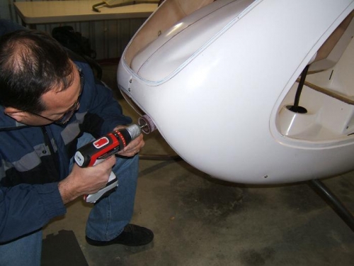

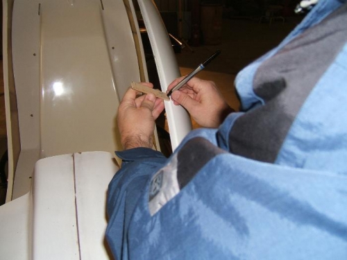

Windshield drill prep.
Marked windshield recess in cabin at 5/16 from edge for mounting screw locations. Need to mark hole locations every 4 or 5 inches then ready to drill.
Also used drum sanding attachment to smooth uneven edges of windscreen and chin window mounting flanges.
Marking hole offset
Smoothing the corners
