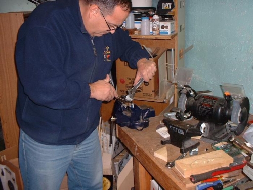

Brief Description:  Swash plate anti-rotation bracket

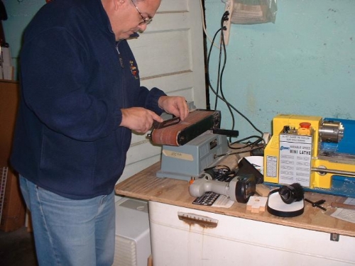

Adjusted agles of anti-rotation bracket mounting surfaces to match the frame hood plate. Adjusted slotted portion to be parrallel to the main shaft. Sanded edges of bracket to remove sharp edges and smoothed slot edges to reduce sliding friction/wear of swash plate anti-rotation arm.
Tweaking the angles
Tweaking the angles
Sanding the edges
Sanding the edges
