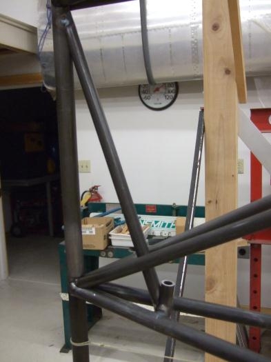

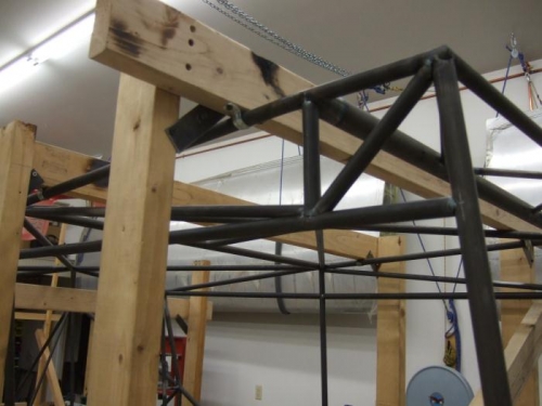

Brief Description:  Upper Fuselage Tubes in Wing Root Area/Tailwheel B
I was able to get the structure done that occupies the space at the wing root. Again, I took a little extra time to get this right since the wing attach points are welded to the small tube that is vertical. It's exactly 32 inches from the rear point. Just for fun, I tried the tubing from one side to the other to see how far off, if any, the dimensions are. The tubes fi!
Got the tubes fit
Got the tubes fit

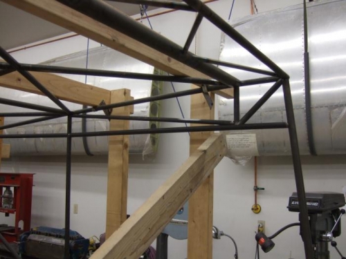

Other side is a mirror image
