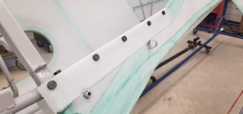

I’m keeping up with the fabric chores. It seems the tapes are endless! This is a neat trick I got from my mechanic friend Jim Harden. The fabric is pretty slippery and tapes slide all over, even if they are almost horizontal. Using these magnets helps hold everything in place for measuring, cutting and gluing.
