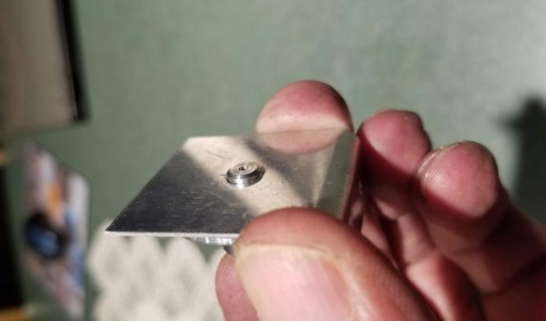

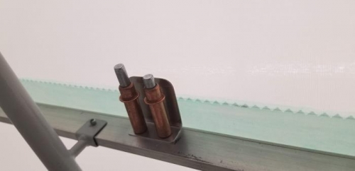

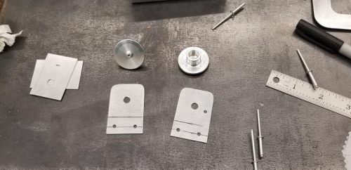

Brief Description:  Static Ports Part 1
Well, now it comes time for the static port location. I decided to go with what others had done and put them in the back behind the cargo compartment. I made a couple of mounting brackets very similar to what Jared Yates did. I really wanted to put these in before it was covered with fabric, but I just pain forgot as it wasn’t written on my punch list. Now it will take at least twice as long. It’s not hard, but it just goes quicker when you have access.I'm using the kit I bought from Saf-Air.
