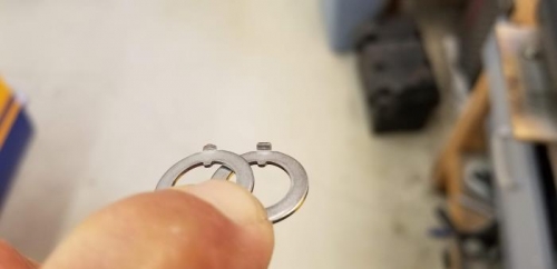

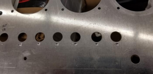

Brief Description:  Swtch Anti-rotation Tabs
In mounting the switches I wanted them not to be able to spin, but without having all the small holes in the instrument panel. So instead of the holes I just drilled a dimple on the backside and using my Dremel tool I put a point on the locking ring tab. Seems to work just fine.
