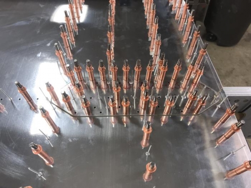

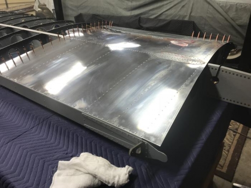

Brief Description:  Installed inner wing skin on right wing
deburred inner wing skin and doubler. Clecoed and final drilled out holes called for the larger BSPQ rivets. Removed and deburred drilled holes. Clecoed skin back down and riveted in called out locations.
