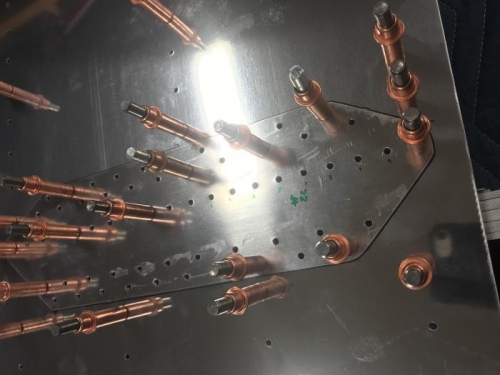

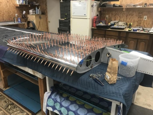

Brief Description:  bottom wing skin installation
Begain install of inner bottom wing skin. Dimpled called out holes and clekoed skin to to skeleton. final drilled holes in doubler to skin and spar flange. Removed and deburred skin, spar and doubler. Cleckoed skin to skeleton again and riveted in called out locations
