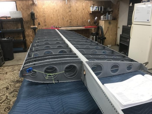

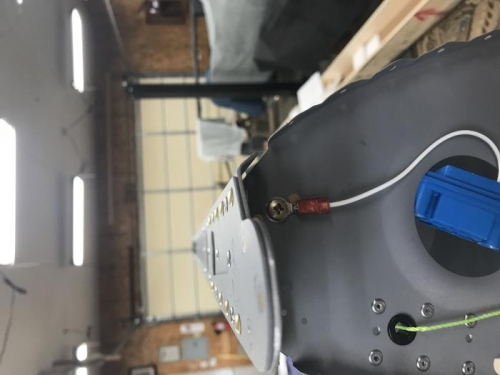

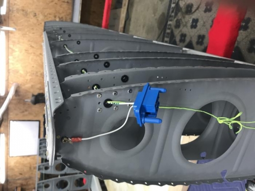

Brief Description:  installed wiring and wing root connectors
Installed bushings in wing ribs and ran wire for stall warning to root. Assemble wing electrical connectors per plans and installed. Also ran pull string for light kit. Waiting for dual landing light kit to be available form Vans. I will have to leave the top skins off the wings to make lighting kit easier to install.
