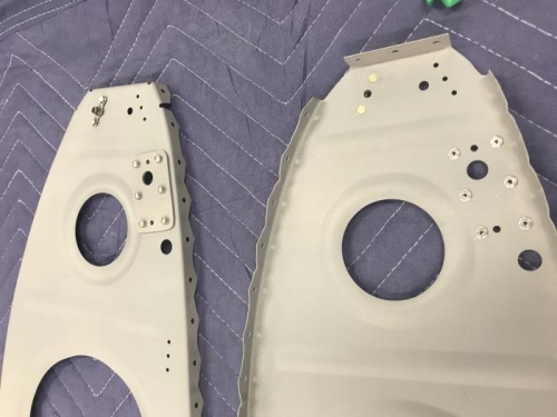

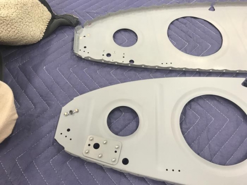

Brief Description:  added nutplates and doublers
debuured doublers and primered. I had to dimple three ribs for nutplats and final drill center holes. Added nutplates and doublers to called out ribs. I put one doubler and nutplate on incorrect 1208-L nose rib that did not have forward flanges trimmed. I had to drill out rivets and reinstall on correct rib that was forward and aft trimmed.
