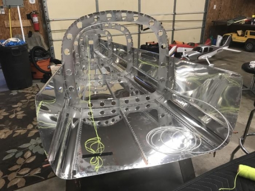

Date:  8-26-2017
Manual Reference:  10-08
Brief Description:  added last former and sides to tailcone
Clecod in aft former to tailcone. Clecod left and right skins to tail cone. Routed string through tail cone for stabilator cables. Routed the trim tab wires through tail cone out the aft end.
