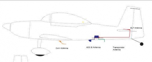

Manual Reference:  Layout of Antenna
Brief Description:  Layout the various antenna locations
Researched what others had done for antenna locations. While the plan may change, currenty I'm expecting to put the antenna locations in the following locations:
ELT housed behind the rear baggage area. Antenna location will be in the fiberglass section of the empannage section between horizontal and vertical stabalizers
Transponder housed behind the rear baggage area. Antenna location to be just aft the mounting location along the centerline of the bottom skin
ADS B to be housed in the same location, behind rear baggage area. Antenna to be located forward the mounting location near the joining of the mid and aft bottom skins
GPS antennas to be located behind the rear passanger area, on the top skin between the sliding rail for the canopy
Side view
Side view
Top view
Top view
