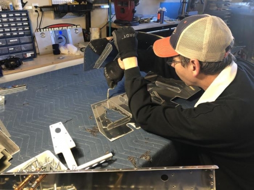

Match drilled all remaining parts. D/A (scuffed) up the outside rib and half rib that attach to the counter weight skin. Debured and preped. Painted the two ribs that did not have the alclad coating.
Debured the rest of the parts including the skin and counter weight skin. Dimpled all skins and dimpled/countersunk those parts listed.
Riveted the sub structure together
Measured the existing trim tabl and fab'd the leading hinge section that was left on the damaged elevator. drill, cleco hinge debured the hinge
Set lines for bending the main skin to accomodate the existing trim tab
Rivet spar assembly with doublers and nutplates
Set the counter weight and applied RTV to the trailing inside edge at the stiffiners
Riveted on the counter weight skin (two rivets on top and two on bottom.)
Set sub structure and riveted the outer rib assembly.
Riveted the trim tab spar bottom
match, debured, dimpled and substructure riveted
Deburing elevator skin
Deburing
Deburing
