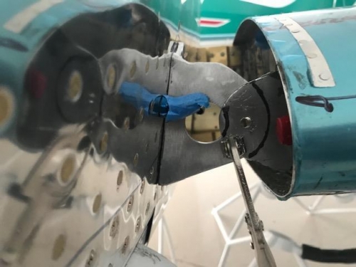

Finsished the rebuid of the left forward tank bracket. Bolted both brackets to fuselage and clamped to tank bracket. (After fitting and removing a couple times to make sure the angle matached the fuselage and existing tank bracket) Drilled the 1/4" hold common between both brackets.

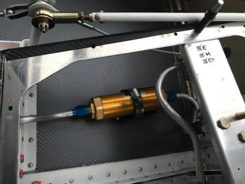

Moved back to the fuel lines. Fabricated the lines from the fuel valve to the filter. From the filter to the high pressure fuel pump. (I had to revove the valve to pull off the "T" formally installed on the bottom of the valve. According to the new information from Van's the new fuel pumps have a return line built on and down require the extra line back to the valve.
Left forward tank bracket
Fuel filter
Fuel filter
High pressure fuel pump
