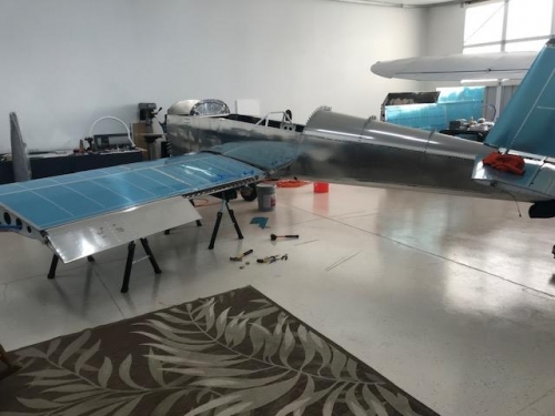

Brief Description:  Removed interior features and insert the left wing
Removed the interior features, floor and various seat pieces to access the push rod assembly for inserting the Wing root.

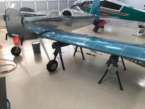

Set up the saw horses to accomodate the left wing. Insert the left wing.main spar. Ski waxed the main spar and chamfered the edges and the spar went in with a little wiggling and pushing. (Jennifer helped me pull the wing from the cradle and set up for inserting the spar
Left Wing inserted
Left Wing inserted
Set up to insert left wing

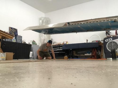

Measuring off of plumb lines
