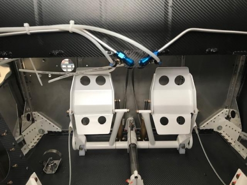

Brief Description:  Ran brake lines and wrapped the rib sections on ba
I finished up the riveting of the hing assembly for the access panel to the rear of the instrument panel.
Wrapped the lower rib section in the baggage compartment that also faces the lower deck inside the cockpit. Wrapped grey inside baggage compartment lower rib and black on the cockpit side. Wrapped the upper rib assembly that faces into baggage compartment. (Wrapped with the tree colors grey, black, with white stripe.

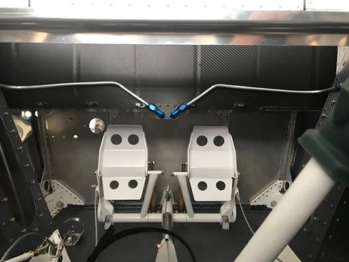

Fabricated the 1/4" brake lines that pass from the center mount through the two gear box towers to the lower hardware that is below the bottom skin by the landing gear. mounted the center mount with the duel clips to hold the return lines back to the brake resevor.
Vinyl wrap for inside the baggage compartment
Brake lines in front of the lower rib assembly that I wrapped in black graphite vinyl
Brake lines with the return lines
