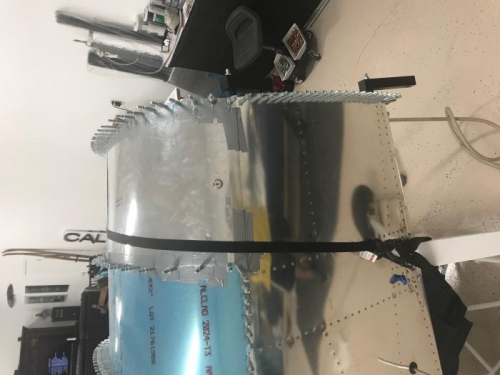

Brief Description:  Alignment and riveting Baggage door
After spending more time than I shoud be flying the L6 and having some epic adventures; I'm back and committed to building
I unclecoed the forward fuselage panel and rear panel to accesses from the inside. Tweaked the door best I could (bent up the side rail and rear skin and tapped it back out best I could. ) Ratchet strap and duck taped the door into place. Climbed inside the cockpit for the first time. Very uncomfortable with the various seat rails, cross rails, and rudder pedals in place. Pop riveted the rear skin on both sides. Removed the ratchet straps and finished up the pop riveting on the forward and rear edges.
Ratchet strap/duck tape alignment
