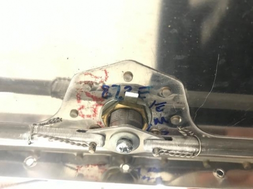

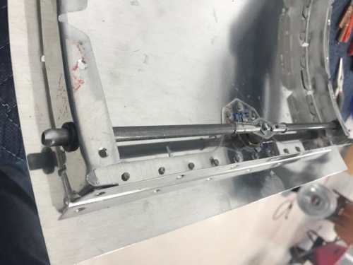

Drill out snap bushings for the 5/16" push rods that lock the baggage door closed. Ream out the lock fitting and debur. Silicone in the lock assembly and bolt into place. Adjust smooth action of the locking pins and lock. Attache the push rod assembly to the lock assembly.
Snap busings and push rods
Lock assembly
Lock assembly
Lock assembly siliconed and bolted into position.  Push rod assembly attached
