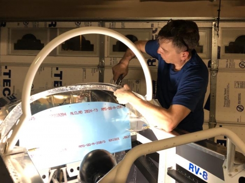

Brief Description:  Match drilling and top skin assembly
Match drilled the hinge bracket for baggage compartment. Deburred and dimpled the two forward rivet holes and the two holes in the firewall.
Cleco in the hinge bracket and match drill the entire forward top skin assembly. Including the holes that attach to the side skins and engine mount #30's
Separate the two windscreen brackets that attach to the windscreen and foward top skin. Align to the holes in the foward skin. Clamp bracket and mark hole locations. I had to push the angle a little to get the holes to align as close as possible to the center of the bracket.
