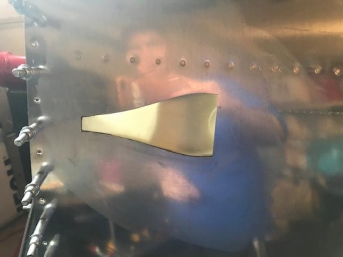

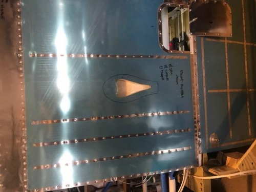

Brief Description:  Prep and seal vent openings. Drill and seal stati
Scuff/DA the metal surface around the fuselage vent and wing vent. Prep the plastic and mix tank sealant. Seal up both the wing vent as well as the fuselage vent.
Smooth filet sealant around the vent area inside and out.

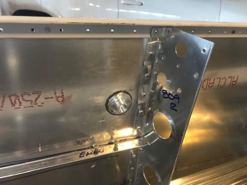

Drill the two port holes in the rear fueselage as indicated on the drawings. I sealed the static ports into place. They static system was a memento from Oshkosh 2018, Cleavland tools

Fuselage scoop sealed into place.
Wing vent scoop sealed into place
Right static port / typical of left
