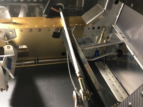

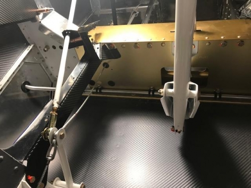

Date:  5-16-2019
Number of Hours:  3.50
Manual Reference:  Fuel lines
Brief Description:  Plumbing for fuel system
Bend, fabricate, and tweak the two fuel lines for the left and right fuel tanks. Flare the for attachements to the fuel valuve.
Mount the fuel lines to the main bulkhead fo rthe right tank and from the valuve to the left access hole through rubber grommets.
I need to mix a little tank sealant to make sure the lines fittings are secured for both the vent lines as well as the fuel lines them self.
I need to order the filter and boost pump to finish the plumbing through the firewall.
line to the left fuel tank
Line to the right fuel tank
