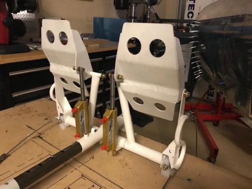

Assembled the rudder pedals, applied a thin coat of grease to the pedal arms
Drilled in the slide blocks and a set of 1" spaced holes for the slide adjustments.
Bolt on the two master cylinders to the pedals
D/A'd the pedals and primed for paint. I picked up some gloss white enamal for finish coat.
Front view of pedals
Black of pedals
Black of pedals
