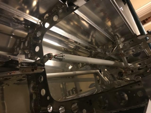

Brief Description:  Connect the mid and aft pushrods for the elevators
Mount the mid pushrod to the transition cam. Bolt the mid pushrod to the rear control stick. Bolt the transition cam bearing to the rib. Bolt the aft pushrod to the top fo the transition bearing and then bolt the aft pushrod to the elevator horns.
The hardware for each pushrod varied, however, the far aft pushrod attachement to the elevator horns required spacers. I eneded up with 3- 960-10's and 1- 960-10L on each side of the pushrods, with the additional suggested hardware.
aft pushrod to elevators
Transition from mid pushrod to aft
