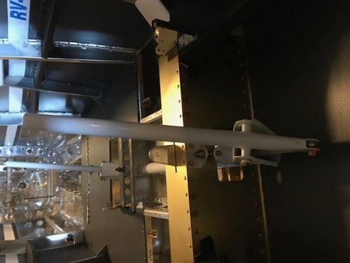

Manual Reference:  Control stick
Brief Description:  Cut and connect control stick
Removed the forward control stick, meausre and cut to what hope is the final length 13" Debur and remount into position. Connected the pushrod and add torque seal.
Spent a couple hours cutting and glueing what hope will be the male mold for a control grip. With a little luck I can carve out the control stick tomorrow.
looking aft from intrument panel
