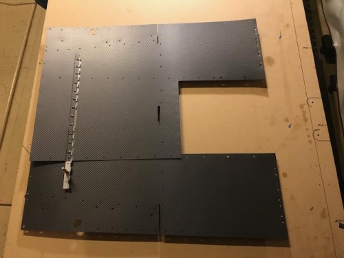

Manual Reference:  Rear floor skins
Brief Description:  Rivet stiffiners and wrap both rear floor skins
After clecoing the stiffiners into place and confirming that I can install both skins with the stiffiners riveted to floor skins. I back riveted the 6 stiffiners remaining to finish all of the stiffiners. The instruction set leads me to believe I should wait on these stiffiners until the floor is set into place and ready to rivet to ribs and nutplates. However, I don't see how you can rivet the stiffiners unless I pop-rivet them instead of solid rivets? (I guess worst case I'll be removing wrapping material and drilling out the rivets for a bunch of stiffiners.)
After riveting the stiffiners into place I applied the Graphite 1080 vinyl wrap to the floor skins. Using a sodering iron I melted out the rivet holes and holes for the nutplates that attach to the skin and the skin to the floor ribs. ( I'll have to apply a small piece fo vinyl wrap to teh remaining hinge bracket once the floors are riveted into place.
Bottom of 831 and top of 830 floor skins
Wrap finish on both floor skins
