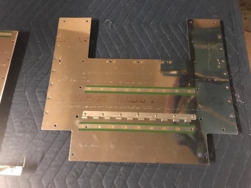

Manual Reference:  Floor assembly
Brief Description:  Riveting nutplates and stiffiners
Back rivet the sitffiners to foward floor assembly. (Dimple forward angle) Rear angle was countersunk previously. Rivet the forward seat hinge to floor.
Rivet nutplates to the 3 pieces that make up the floor skins. Also rivet the nutplates to the baggage compartment.
Forward floor skin with front seat hing riiveted to assembly
