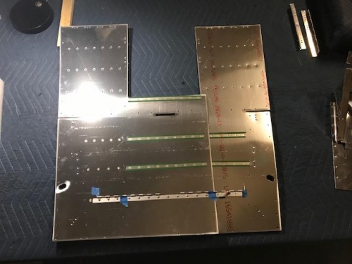

Separated out more floor stiffiners. Edge deburring, match drilling, deburring, and dimpling. Back rivet on some of the stiffiners, as designated. Rivet rear hinge to main floor.
Fabricated the spacer for the smaller floor assembly space from overlaping .023 aluminum. Debur floor struts in fuselage and rivet on nutplates.
Happy New Year.
Forward floor assembly
rear floor assembly
rear floor assembly

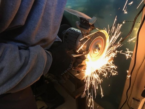

Grinding visegrip edges for a hand riveting tool
