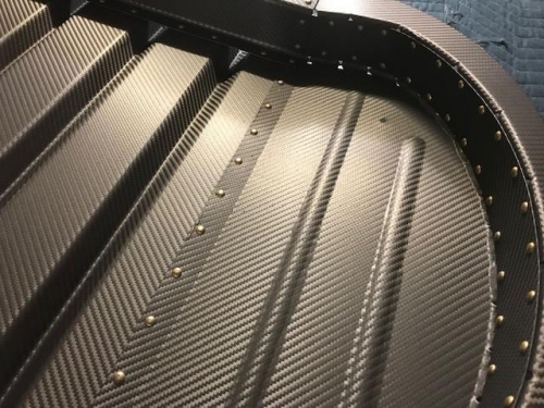

Manual Reference:  Rear seat back
Brief Description:  Rear seat back and interior finish
Debur all of the parts associated with the rear seatback assembly. Fabricate hinge mount for seat assembly. Cleco all of the parts together and match drill all holes between parts. Disassemble the whole assembly and debur the holes.
Apply the 3m 1080 vinyl wrap (Grey Graphite vinyl) to all parts. Then recleco the seatback assembly and rivet the parts together.
Rear seat back assembly

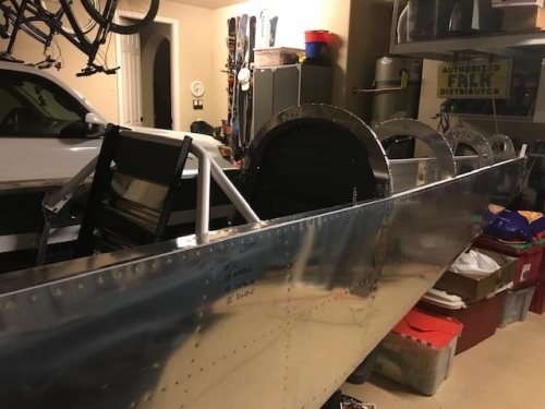

Interior finish
Interior finish
Rear seat back sitting in place
