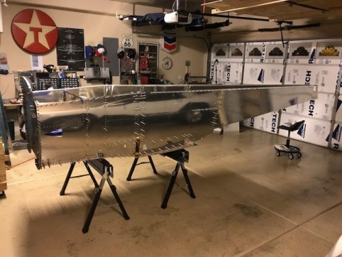

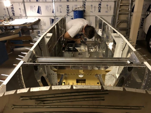

Back riveted the middle Longerons to the left and right rear side skins
Cleco the rear skins to the fuselage/mid skins and upper longerons

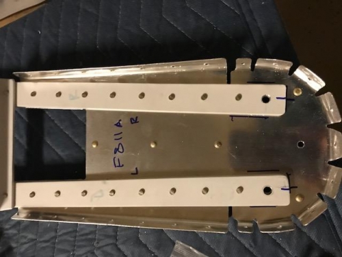

Rivet the Stabs on the 811 rear bulkhead. Match drill the lower holes to the 409 WD tailwheel assembly.
Match drill the 1/4" holes in the tail wheel assembly to match up to the Slab assembly and tailwheel weldment''
Trim the tabs on the very far end of the Longerons
