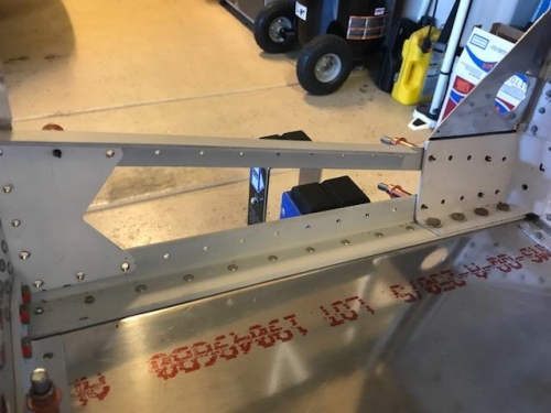

Install the 4 bolts that attach the lower longeron to the forward mount. Torque to specification.
Install the 2 center screws in the lower longeron, torqued to 20 inch pounds+ 5 for the lock nut, 25 inch pounds
Rivet the lower longeron to the floor assembly for both left and right sections.

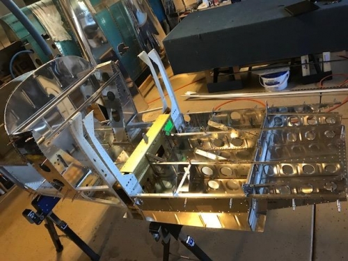

Cleco the mid floor assembly to the forward assembly. cleco the main bulkhead to the assembly. Rivet to the two mid cabin braces to the main bulkhead, including the platenut. Bolt the two braces to the bulkhead and torque the bolts to specification 75 inch pounds

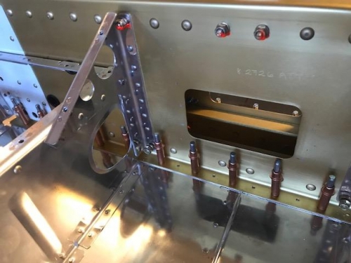

Applied torque seal to all bolts.
Rivet the seat ramp brackets to the mid rib assembly
Forward and mid assemblies attached
riveted seat ramp to bulkhead
Lower longeron bolted and riveted to the floor assembly
