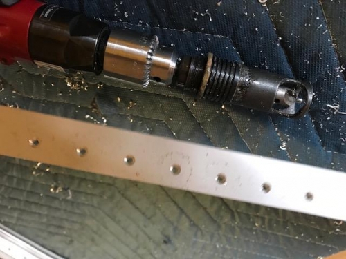

After soaking Jewel's gifted countersunk tool in oil for a couple weeks, I pulled it out and set up the countersunk tool for #30 and left my new one with the #40. (It was fun to see that not much has changed in 50-60 years. She used the countersunk tool while an employee as Fairchild Aircraft where she was a Rosy the Riveter, riveting wings and fuselage assemblies and later she worked on electrical assemblies for the A-10)
Jewel's gift of her old countersunk tool
