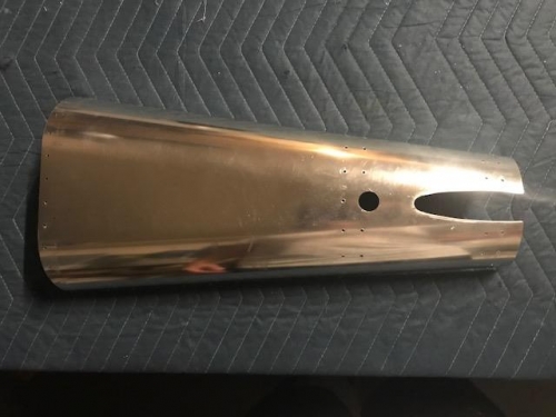

Manual Reference:  Fuselage skin
Brief Description:  Cut shape out of tail skin for tailwheel assembly
Made a copy of the full scale cut away section for the rear tail skin 828. Overlayed the pattern and drilled/cut away the section to provide releaf for the tailwheel assembly to mount through the skin. Also drilled out the 3/4" hole for the nut on the tailwheel assembly.
828 tailwheel skin with cut away section and access hole
