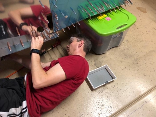

Brief Description:  Match drill mid skins and bottom skins. Drill upp
Match drill the #40 and #30 mid skin sections, both left and right.
Match drill the #40 holes on the bottom skin tail assembly, including the far aft bottom skin tabs that are not pilot drilled.
Drill the upper longeron locations for both left and right tail side skins. Slow going since it requires two or three holes then cleco and clamp to keep everything aligned.
*it was also slow due to the temperature. Out side 113 and the garage was 90, So it was hourly breaks, jumping into the pool to cool down.
