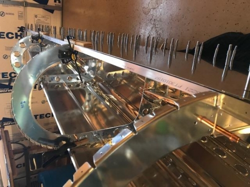

Unclecoed the side skins forward, mid, and rear to allow the longerons to nest down in to position. Fitted the upper longerons and notched the longeron to fit the 811 rear bulkhead suppport that transition through the longeron. Re-clecoed the side skins back to snug against the longerons.

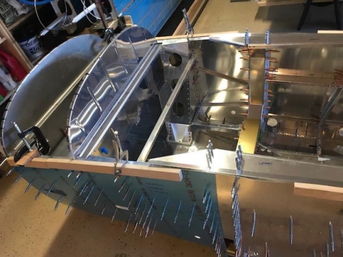

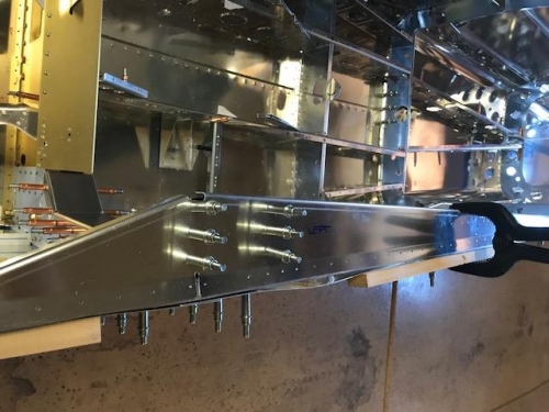

Debured the box covers and both rails. Clecoed on the covers. I had to trim the rails in the rear to avoid contact with the bulkhead. Clecoed the rails into place.
Clamped the upper longeron into place. Clamping the forward engine mount weldment to the longeron. (I found it best to cut sections of wood to support the clamps and apply even preassure against the skin)
forward fueslage with clamps and you can see the box covers
Left rail
Left rail
