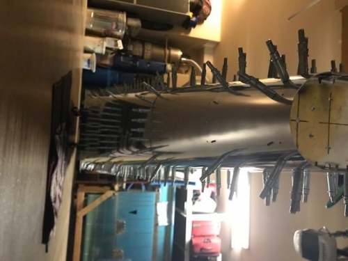

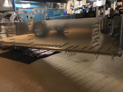

Uncleco the lower sides of left and right side skins. Uncleco the bottom aft skins on the floor. Sandwich the tail bottom skin between the rear bulkhead and bottom skin. Cleco into position. It took quite some time to get the holes aligned. They were extreamly tight.
Bottom tail skin
Bottom tail skin
Left fiew along the fuelage
