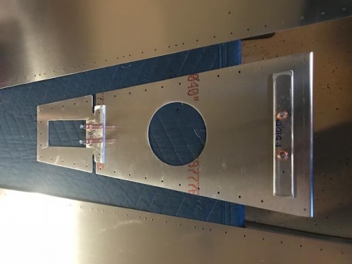

Rivet the rear seatbelt assembly to brackets. Rivet the nutplates to the rear deck angles.
Debur various parts including back plate and spacers, both Mid and lower longerons. Debur bottom and side skins for the rear tail assembly.

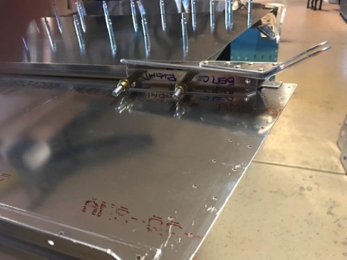

Cleco the seatbelt assembly to the lower longeron and cleco the mid and lower longerons to the both side skins
Clecoed the 807 bulkhead to the mid assembly
rear top plate and spacers
Seatbelt assembly clecoed to the lower longeron
