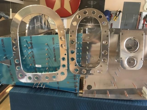

construction of the rear bulkheads for the tail as
Match drilling, deburing bulkhead assemblies, including rivetingleft/right sections together for 807, 808, and 809 bulkheads
Match drilled, debured, and riveted the seatbelt doubling plates for bulkhead 807. Cut away the 6 sections in the bulkhead
Fabricate the 857 seatbelt mounts. Match drill and Debur seatbelt mount/assembly.
807 bulkhead with riveted doublers on seatbelt. Riveted left/right holes at bottom center
808, 809, and 810 bulkheads
