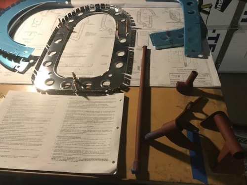

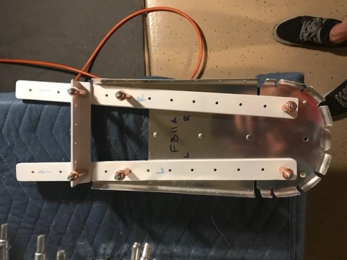

Assembly 811 bulkhead pieces. Flute the ends to confirm straight. Rivet the attachment holes between the two bulkheads.
Match drill the 810 angle attachment to the 810 bulkhead. D/A the angle and paint with primer.
Cleco assemble the 809 and 808 bulkheads
809 bulkhead assembly and lower right is the primered parts for the tailwheel assembly
811 Bulkhead, riveted attachments between two pieces
