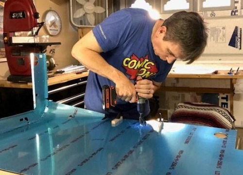

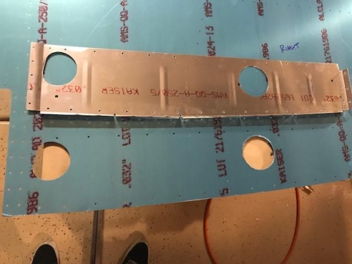

Clamped the right outer rib to the work bench on a piece of scrap wood for drilling/cutting large 2 5/8" vent line hole. Cut the vent line with the suggested fly cutter. Clampped the skin to the table and cut the vent line hole in skin as well. (I'm still surprised just how nice of a cut you can get from the fly cutter)

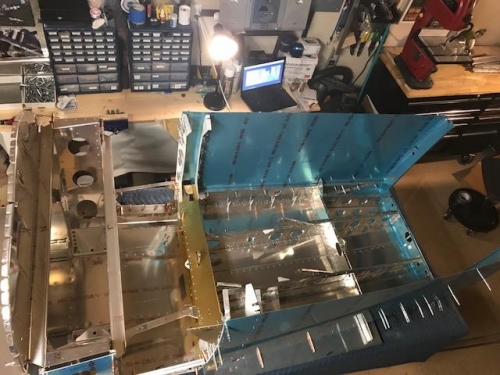

Clecoed the floor assembly to the main bulkhead. clecoed the seat ramp to the inter ribs and clecoed the outer 815 ribs, forwar and aft, left and right. Also clecoed on the left and right mid skins.
Right rib and skin with large vent line holes
Mid skin and floor assembly
Fly cutter cutting hole in right mid skin
