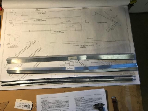

Fabricate the Lower Longerons. Followed the three steps.7.25 degree twist. Opening up the face of the angle, and then applying additional twist to shorter section. Mirrored the right lower longeron as well

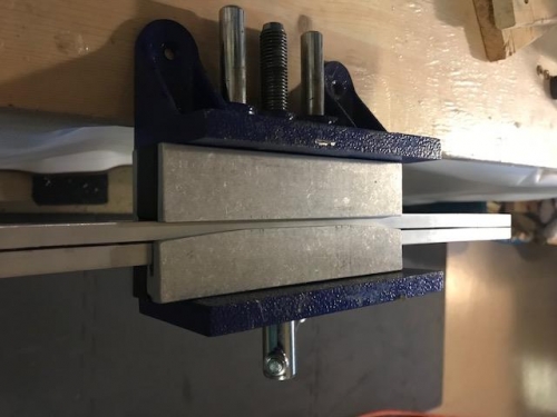

Bending the Auxilary longerons
Success, Micheal Wardles gift (Bending Jig) for the longerons worked awesom on the auxilary Longeron to put the 5/16" bow into place. Followed the same process for the right longeron as well.

Micheal's gifted longeron bending jig
Fabricated Longerons
