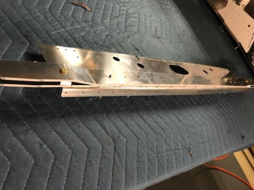

Brief Description:  Finish up the bulkhead assembly and start the rear
Cut two more spacers to make sure all four corners are spaced out for the wing spar into bulkhead
Drilled the platenut pieces for the rear rudder brackets. Riveted the platenute on the flange. Riveted top flange between two bulkheads.
Torqued the two bolts for seat lugs and brackets. Clecoed the bulkhead to the floor assembly.
Began the rear bulkhead seat assebly. Cut the 1/4" spacers match drill the #30 and final drill the #12 bolt attachments at each end. Flute the 814 ribs
Main Bulkhead assembly w/ spacers
